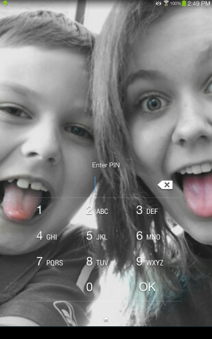

I finally got my tablet to install the firmware update after trolling through a thousand forums and trying about a million things ;D Here's what worked for me:
  • Charge tablet to 100% using wall outlet, not computer usb port
  • Unmount and remove SD card
  • Power off - The only way I could get mine to do this (and it didn't even work every time) was from my lock screen where I enter my password (See screen shot below). It never worked for me from my home screen or anywhere else.
    Hold down the power button and choose "Power Off". Not restart.
  • After successfully powering off to the screen where you see the blinking battery (might have to try it 4 or 5 times to get to that complete power off), press power button for 2 seconds to turn tablet back on.
  • When tablet is back on and you get to your home screen, re-insert SD card
  • Download update by going to Settings>About Device>Software update>Update
  • Once update is downloaded go ahead and choose "Install Now"
  • Message will pop-up saying device will restart. Touch "OK"
I tried all of these things so many different ways and in different orders I'm still shocked that I finally got it to work! I think that it will only allow the update to install after a complete power off. Don't know if it will work for anyone else but I hope so since it doesn't appear that Samsung is going to have a fix anytime soon.
Good luck!!
