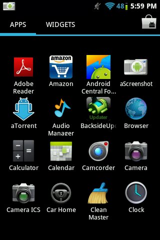

Given up. I'm just gonna stick with BACKside-IHO. Best performance. Most compatible. Clearer camera than stock. So I got an adw theme along with a launcher and tweaked settings so now my phone could be fooled for JB (if you've never owned one).
SCREENIES:
Sent from my LG-VM670 using Tapatalk 2
