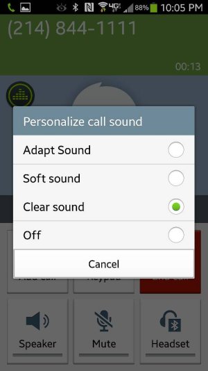

Having same issues. To my knowledge it's clear on the other end. Crazy experiment though...As you are on a call there is a weird round icon towards the top left of the screen. Click on that and change from Auto to Clear and see if that helps. Pics below
