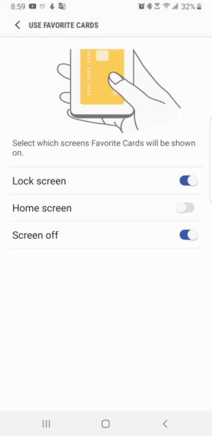

Realistically, just shut off the Samsung pay on the home screen and leave it on the lock screen and when off. How many times are you really using your phone at the same time you are paying. Just swipe up from the lock screen or when it is off.

I'm actually surprised that I'm enjoying the gestures! Im still using Action Launcher and I have Samsung pay on the lock screen and off screen so it doesn't interfere with the gestures at all.
How did you get it setup like that ?
