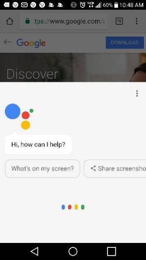

I'm confused as to what the problem you guys are experiencing.
Maybe a screenshot would help
I can confirm that this happens with Nova launcher as well. But only with the built-in home button launch... If I use the Nova persistent search bar it does not happen. I believe this is a bug with Google Now (an incompatibility with LG UI) and will likely be fixed by Google.
The attached screenshot is what I get with home button. If I long press it no longer gives me screen related info but allow me to press "what's on my screen"
