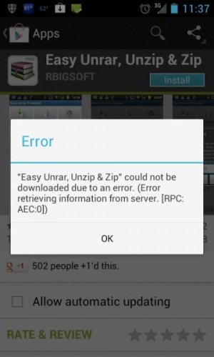

While waiting for JB, I did the 'clear data and clear cache ' of course with no results, however ever since then I can access Google Play but I am unable to download anything. I get an error message saying the server cannot be reached. I have signed out and back in with no luck. What am I missing? I searched the forum but no luck. Help! I included a screenshot of error message. NS4G, stock, not rooted 4.0.4.

If you have the option to "Uninstall Updates" on the Play Store app then give that a shot, if it works great! It should re update the Play Store then again on its own.

Okay, I did that, did a battery pull, resigned into Google (on their home page), tried to download an update to an app, again, got an error code; " ...could not be downloaded due to an error (-101) Any other suggestions? At the worst, I suppose, JB will fix that, but I would like to update a few apps while I'm waiting and waiting. :D

Interesting..... Ya JB would in theory overwrite it and give you a new Google Play Store but still what a bunch of BS.

Yeah this is a know, intermittent side effect of doing what you did. Try forcing a download from your browser. It'll eventually right itself though.

check if you accidentally disabled the framework services when doing the force stop/clear data...if so, enable it again and see if that helps.

I got JB OTA today and that seemed to fix the problem. I never realized how much I depend on market apps. :eek:

This is why you DON'T do the framework trick as it will break things until you finally get the OTA....
