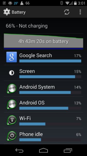

Yikes, sideloaded 4.4.2 last night and Google Search is destroying my battery life. The phone has only been on less than 5 hours (Screen on time was about 20 minutes) and you can see the battery is getting destroyed, primarily by "Google Search". Any ideas?

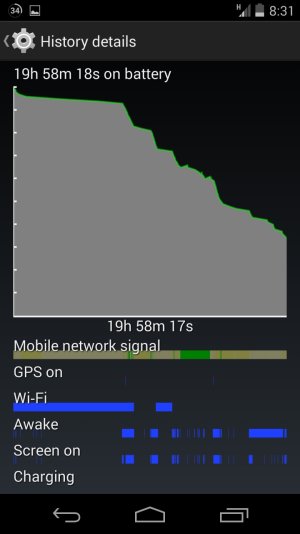

Well, IMO it's not a problem with 4.4.2, but rather with settings on your phone. It may take a bit of digging to find what app or setting is causing this activity. Here's a screen shot of my battery usage, using OS 4.4.2. I've been using my phone a lot today, but still am on track for about over 15 hrs usage (with over 4 hrs screen on time so far.
What I see from yours is typical of what I would see on mine, until today. No changes in apps loaded, etc. If this keeps up I may wait until Google posts the 4.4.2 image and then load that clean and see what happens. Not looking forward to setting everything up again. BTW this is indeed stock and not rooted.

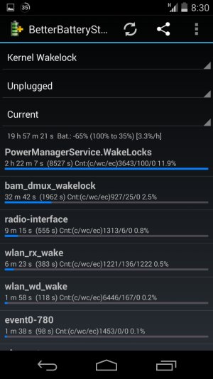

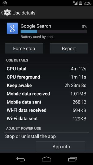

I got the 4.4.2 update as well. Battery seems to be doing better. However, just now the google search put a wake lock on for absolutely no reason for a couple of hours. Screenshots below. So it's still happening with the google search app, I'm not really sure what setting is causing it. The process itself (associated with google search) is called "EntriesRefreshIntentService". The first two shots show the awake time and the wake lock that caused it. You can see it again in the last shot.
It seems to be discussed at length here http://forum.xda-developers.com/showthread.php?t=2534637 but they did not seem to find a solution.
