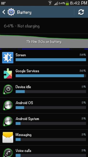

Uninstall your Google Play Service updates and then re install them. Mine was doing the same thing and that totally stopped it.
Thank you very much, this solved my battery drain issue! The "Google Services" task was consuming most of my battery utilization and uninstalling and re-installing the Google Play Service updates immediately fixed the problem. Now, "Google Services" is using about 2% whereas before it was consuming over 50%. Thanks again for the tip!

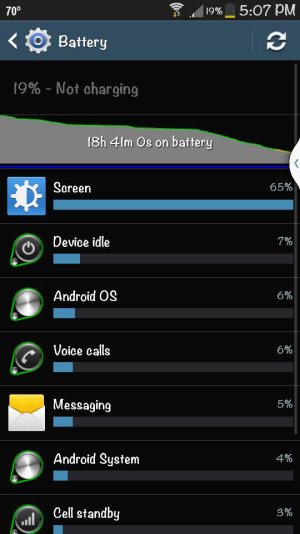

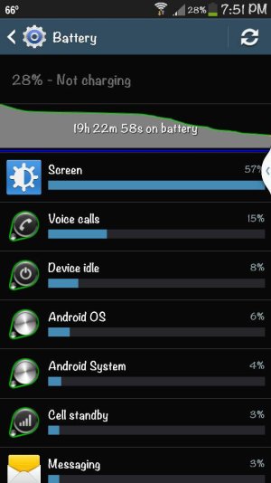

My battery stats for today. Could I make it better?
sent from my galaxy s4

It is my humble opinion that undue reliance on these battery stats is unjustified and that you have to look to overall battery life in the context of use. The percentages shown are not unlike mine, yet I get superlative life depending on my usage. When I am home on the weekends, where I have wifi and a microcell, such that all signals are top quality, I use 1-1.5% per hour. When I am out and about without wifi, spending my day in areas of better and worse coverages, I use 3-4% per hour. When I sit at home in the evening and use watchon (or touchsquid, which I like better) as my tv remote to flip channels and change volume, I use more power more quickly.

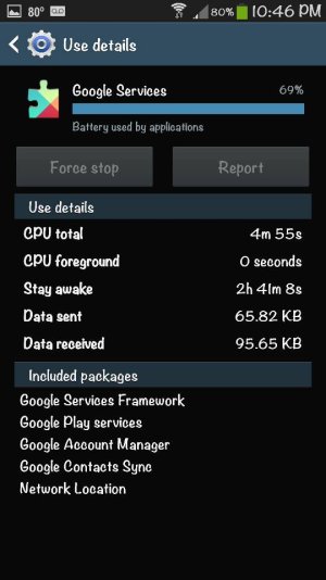

i did this last night and i still see google services.. i uninstalled it again and then restarted the phone.. hopefully that works better.. i charged my phone last night and after 3hrs i was down 5% and 58% was google services
3 hrs, 5%, that's an anticipated life of 60 hours on a charge. Darn good if you ask me. Right now "device idle" is 23% of my usage, I am at 17 hours with 75% remaining. I don't see any reason 58% of almost nothing should be of any concern. That's a consumption of 0.966% (58% of 5% divided by 3) of a full charge going to Google Services per hour.

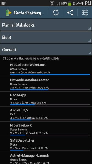

Settings/more/location services <--- disable "use wireless networks". This cut down on the wakelocks from Google Play Services by about 95%...but of course I lost that feature, which I would prefer to have.

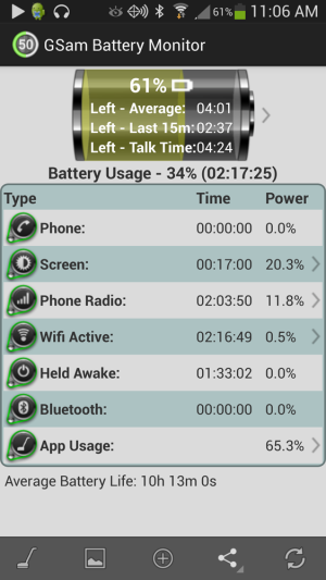

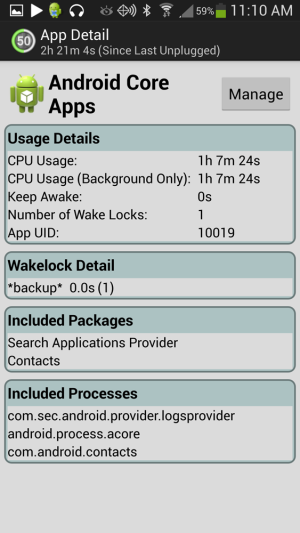

I updated to the new VRUDMI1 software on Tuesday and have been having major battery life issues ever since. Initially it was Google Play services, but the uninstall of updates fixed that. Now, I'm getting a major drain from Android Core Services. According to GSam Battery Monitor, they are using 33% of my battery life (specifically the Contacts app). Force stop on it isn't helping. I turned on my phone 2 1/2 hours ago with 94% power and I'm down to 63%.
It should be noted that my office has terrible phone reception, but even putting the phone in airplane mode isn't stopping the drain. Before the upgrade, as long as I had my wi-fi on, battery life was normal (I'm a heavy user and get about 24 hours of use out of a charge). Help!
I'll submit screenshots shortly.
