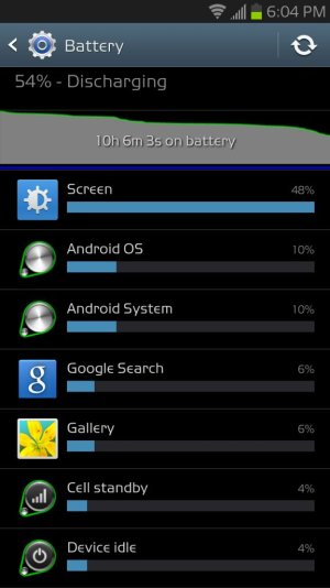

I turned OFF "Sprint Connection Optimizer" and just turned my WiFi on all the time.
I turned OFF the "Auto Adjust Screen Tone"
I turned ON "Battery Power Saving Mode" minus the CPU
I turned OFF the "Auto Location Update" in Google Maps but have Google Now turned ON
I manually Sync everything when needed
Screen brightness is at about 40% with Auto turned OFF
Battery seems to be doing pretty good now and included a usage screenshot.
Sent from my SPH-L710 using Android Central Forums
