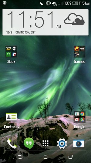

Hey guys, my GPS satellite dish keeps staying on. Its draining my battery and using data. I'm not sure what's causing it to do this. I've closed all apps and even turned location services off. Any ideas how to get this to go away?

I don't have an M8 but you might have an app running in background that is scanning GPS. I would try starting the phone in safe mode and see if GPS goes off. If it does then you have a rogue app that is constantly scanning GPS.

In this case I think something else is going on. Location is turned off but the GPS icon now pops up a lot. Not constant like others but the behavior has definitely changed in the last few days. My guess is Google pushed an update to Google Services causing this change. Or the recent HTC Service Pack did something. How else can you explain Gps is off, Location is off, but the GPS icon pops when turning phone off, turning phone on, and periodically all day? Crap like this makes me want to pop the sim back in my iPhone 6,

I did but did you read my part that said I have location turned off? I have nothing in there even when turned on just Google Location Reporting but it is still off and I get that icon regardless.
I do agree, something is triggering this, obviously. Google or 3rd party but not from what you see in Location. Blank slate there.
