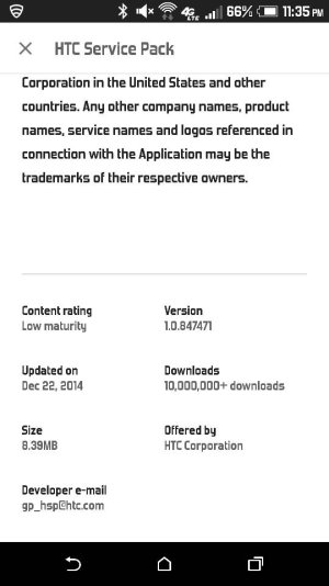

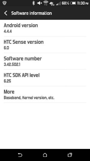

Would you please provide your Software no. and HTC service pack version,

Here is the HTC service pack info.
