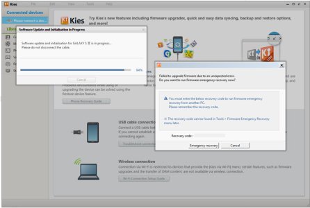

After trying far too many things which didn't work, I ended up trying to do an emergency firmware recovery. When it got to the bit where it displays the recovery code, the box was blank so I ended up cancelling it and trying again but the code was still blank.
Now when I plug the phone into the pc it comes up with the "firmware upgrade encountered an issue...." and suggests I use Kies - the problem is that of course there's no recovery code!

This is what I get when I try to do the firmware upgrade & initialisation and of course I can't do the recovery because there's no code upgrade-failure.jpg
Thanks for clarifying things. Kies wont work on a rooted device even though it may not have a custom rom. Your only option is to track down the exact firmware for your device (sammobile) snd flash it using odin. There are many good tutorials on the net.
