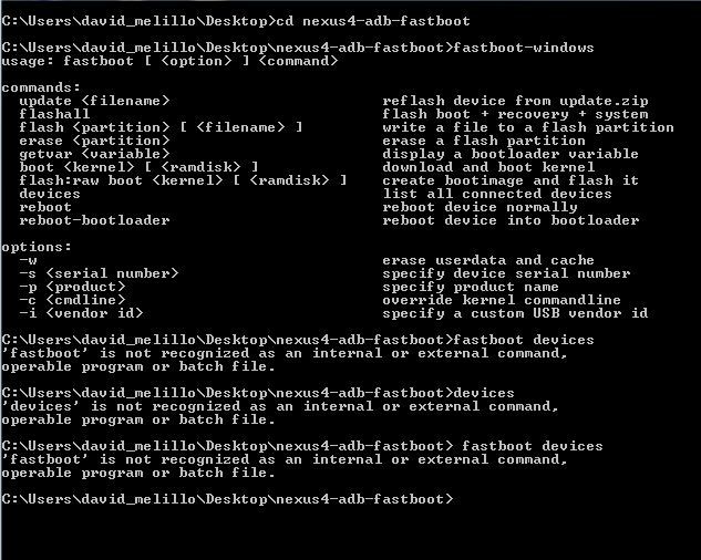

Most definitely completed that step. Tried on a mac and a pc at this point ... I have a screen shot below, maybe that will help show where I am going wrong?
The '-windows' part is part of the filename and needs to be included in each command.. Such as:
fastboot-windows devices
