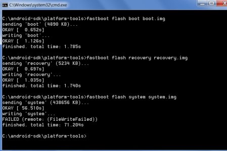

Looks like you're making progress... Try unzipping the main image file, and taking the parts which aren't flashing (boot and recovery are going in your second screenshot, but system and whatever comes after are not) and doing them manually, using:
Code:
fastboot flash system system.img
etc...
Sometimes just doing them one by one will get it going.

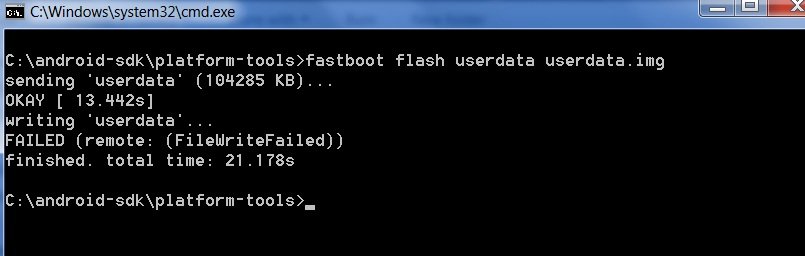

I've tried it and it only fails when flashing system and userdata. 3.jpg4.jpg

In my experience when the flashing of a .img file fails, it helps to:
-change USB port (try using a USB 2.0 port and not a USB 3.0 (blue color))
-plug the USB cable out/in again for each and every .img you're flashing to prevent your computer for putting the USB port to "sleep" (just check that it's properly connected by using the "fastboot devices" command after every time you plug it back in.
- try another computer (start all over again!) :P

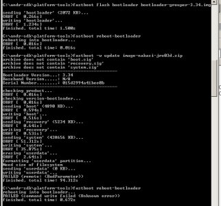

Re: [GUIDE] Factory Image Restore for your Nexus 7
Thank you for a great tutorial.
I have not been successful using this sequence with my bricked Nexus 7.
All went well up to "formatting 'userdata' partition..."
I have included a screenshot herewith.
Any help would be greatly appreciated.
Thanks in advance.
In case the attached screenshot didn't come through,
I have manually typed the cmd mode lines starting before the error occurred:
cmd issued: fastboot -w update image-nakasi-jro03d.zip
sending 'system' <438656 KB>...
OKAY [ 51.312s]
writing 'system'...
OKAY [ 35.875s]
erasing 'userdata'...
OKAY [ 2.641s]
Need size of filesystem
sending 'userdata' <0 KB>...
writing 'userdata'...
FAILED <remote: <BadParameter>>
finished. total time: 94.312s
