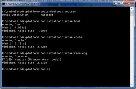

Hello everyone,
I'm having some trouble with a bricked nexus 7. However I am able to access fastboot mode. If I turn on the device it stays at the google logo with options to start/restart bootloader/recovery mode/power off. Nothing happens if I press start. Recovery mode will not work and will show android with a red sign. I am however able to restart bootloader and turn off the device.
I tried the tutorial and it failed at step 6. fastboot erase recovery. This text will show up on the N7 "Neither USP nor CAC partitions found"
And I've also found out that my device is not recognized with command :adb devices ( no serial )

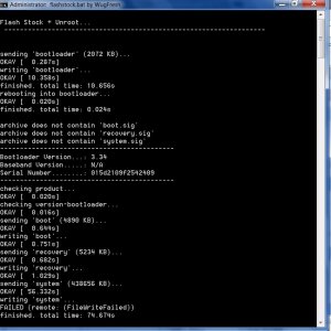

Did you receive a response with Step 5 (fastboot devices)? That would confirm if the drivers are correctly installed and everything is configured. As you were able to use the toolkit you mentioned to unlock and root, did you try just using it to restore the factory images? I know Wug's has the option, could be worth a shot if fastboot commands are giving you trouble: http://forums.androidcentral.com/ve...s-root-toolkit-v1-5-3-updated-08-18-12-a.html
Re: [GUIDE] Factory Image Restore for your Nexus 7
Thanks for the reply guys. I tried step 5 and it showed a serial somehow. This time it failed at step 7 writing bootloader (bad parameter)
I would try it a few times. If it keeps failing try to include a screenshot so I can see exactly what's happening.

Looks like you're making progress... Try unzipping the main image file, and taking the parts which aren't flashing (boot and recovery are going in your second screenshot, but system and whatever comes after are not) and doing them manually, using:
Code:
fastboot flash system system.img
etc...
Sometimes just doing them one by one will get it going.
