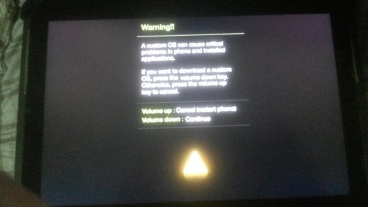

The instructions on how to boot into recovery mo longer work on a Samsung Galaxy Tab2 10.1 tablet.
When you hold power and vol up at the same time, the logo no longer appears.
It just brings up a warning screen that a custom OS can cause critical problems.
It then goes on to say that if you want to download a custom OS, press the volume down key or volume
up to cancel.
Pressing volume down goes to the ODIN screen. Downloading... Do not turn off target!!
It stays on that for hours, doing nothing.
Are there new instructions?

This method of booting into the recovery no longer works for me on my Samsung galaxy Tab2 10.1
I have used it in the past, but trying to use it this weekend, holding down the power button and volume up until the logo appears does not work. Instead, a warning appears that installing a custom OS can cause critical problems, and that if I want to download a custom OS, press the volume down key or volume up to cancel.
On pressing volume down, I am taken to an ODIN load screen. Downloading... Do not urn off target!! which it stays on for many hours until I power it off.
Has anybody got any idea on what I should do next, please?
Long press the power button to simulate a battery pull. As for the rebooting into recovery, I'm just making sure, but you did hold just power and volume up?

Thanks, I could restart the device bu can't get into recovery in spite of just holding power and volume up.
if i do the power button thing, i don't end up on the screen with a blue bar. first it asks me if i want to download a custom os, if i continue with it, it just brings me to the odin mode. if i cancel it, it'll just turn my tab on. what am i doing wrong? i can't seem to get to the screen with options. i have android version 4.2.2 20150331_211750.jpg
Try again, but make sure you are pressing volume up, power and home.
