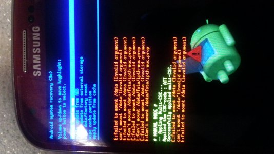

I have an issue with an AT&T Galaxy S3. It is stuck in some unknown mode with the Samsung logo and a blue status light. It became that way after trying to do a factory reset. And has been stuck there for about a week. So I've took to the forums for some help so that I can unlock it and use on T-Mobile.
I've done this reboot thing in the recovery mode as described here. Same problem, it doesn't work. I'm attaching a screen pic...
Please let me know how to address this issue... Please?
Try selecting factory reset, and then reboot. Volume up and down to navigate, power to confirm.
