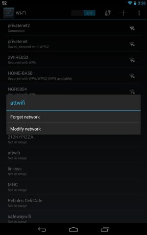

1. On your device, go to System Settings/Wireless & Networks/Wi-Fi, select the Wi-Fi network that you’re trying to connect to, and tap “Forget.” Then reconnect by selecting that network again and entering whatever password that may be needed.
If the network to which you’re trying to connect has a common or generic SSID (like “HHonors” at Hilton hotels, or “linksys," which is usually the default SSID for Linksys routers), then your device might be trying to use previously stored credentials from a past connection that won’t work for this new connection. So, for example, suppose you visited a Hilton last year and used their “HHonors” wi-fi. Your device remembers this connection unless you tell the device to forget it. If you go to a different Hilton now, the SSID for their wi-fi will still be “HHonors,” but the credentials that are saved on your device may not work. You need to forget your old “HHonors” network, then select the current “HHonors” network and log in again.

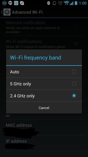

7. If you have a dual-band router (i.e., 2.4 GHz and 5 GHz), see if you can set your device to use only the 2.4 GHz band. Sometimes the Auto settings will cause problems. Go to System Settings/Wireless & Network/Wi-Fi, tap the Menu button again, and select Advanced/Wi-Fi Frequency Band.
Then select "2.4 GHz Only" instead of "Auto":

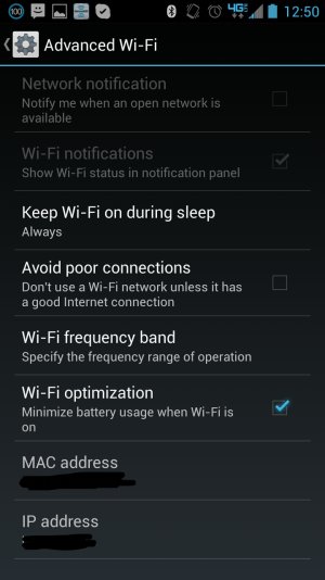

8. In item #6 above, you can see an option for "Avoid Poor Connections." If you check this, then your device won't struggle to maintain a connection to a weak wi-fi network. However, this may also prevent your device from connecting to a network that it otherwise could use. Uncheck this option if the network to which you're trying to connect shows only 1 bar or so.

10. Turn off Wi-Fi Optimization. You can see the option in the screenshot above. This option is for battery saving, not for improving wi-fi performance. Turning optimization on will actually make the wi-fi radio activity more intermittent (in an attempt to save battery), and therefore might hinder the performance of some apps that require a more constant connection.
