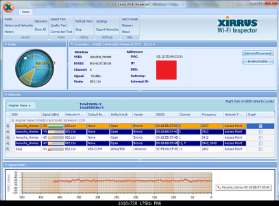

Hi,
I live in a hostel where login based public wifi is provided.
I have a samsung S3 which connects to the wifi even at peak hours of traffic and gives full speed.
While when I connect through my laptop's wifi which is relatively newer than S3, it barely gives any speed, even googling is not possible. But at non peak hours when there is less traffic, sometimes it gives decent speed.
Recently I bought oneplus2 whose wifi performance is similar to my laptop's wifi performance.
All the above devices are able to connect to the wifi with atleast 3 out of 5 bars. I don't understand why when S3 gives proper speed, at the same time other device's wifi fail to perform which are relatively new. These new device's wifi should atleast perform similar to S3, if not better.
I don't have control over router's config as it is managed by hostel management. I am attaching screenshot of the Xirrus wifi inspector which gives the details about the router.
Please suggest if there is anything that I can do to improve the wifi performance on those devices.
