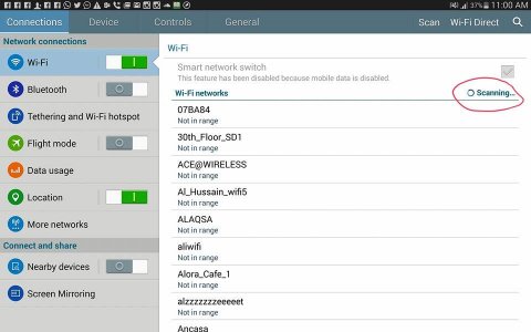

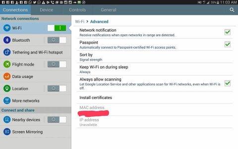

my Android KITKAT has been updated into Android 4.4.2 KITKAT for Samsung Note 10.1 2014 and breaking my head to connect to wi-fi which it shows 'Scanning...' in a loop and there is wifi signal available in my palace. If you found any solution
