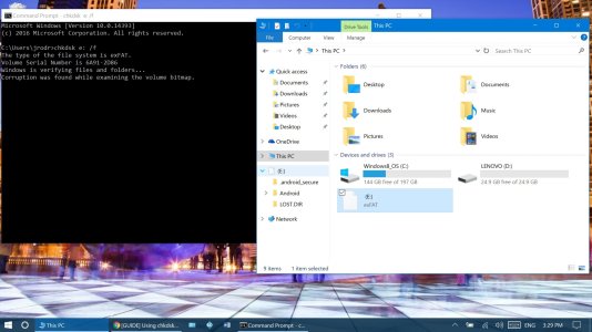

I'm stuck. I ran chkdsk and get " the type of file system is EXFAT. CHKDSK is not available for EXFAT drives"

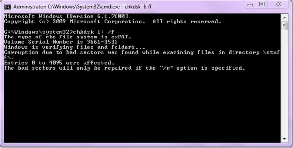

What do i do next, i try to put in a cmd /r but it wont let me type

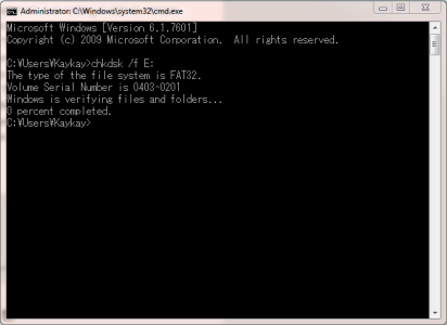

Hello, I have a 32gb sd card that my android says is corrupted. I tried doing the cmd command to fix it, but it doesn't seem to be working... sd snip.PNG Everytime I run it, it gets stuck like that. I've already tried fixing it normally on windows, and gotten everything important off of it, but I'm still unable to format it on my pc since my android doesn't want to. I couldn't care less about what's left on there, just need the sd card to work. Is there any hope?
