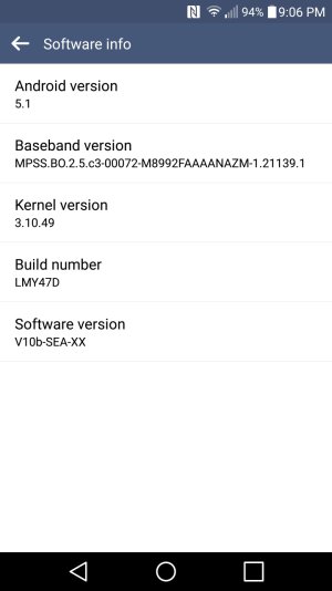

As some of you know I got my H815 not long ago, just been messing with it, see lots of stuff that I'd like gone and to learn what they do. I'm new to phones so I guess I need to unlock the boot loader / root it and then install TWRP most likely. Rooting and such seems to still be kinda sketchy and I'm scared to try it myself, I don't have another $500 if something goes wrong. So if someone could walk me through doing these things, live, via FB, Steam, any messenger, etc. I'd personally like to do Team Viewer. I can pay via Paypal for some help.
I also believe I'll need to flash my firmware I guess since it's saying 10b?
So please send me a PM with your contact details so we can get started, I'd like it done ASAP.

So if I get it unlocked me next issue is the 10b. I don't know which one I need, 10c? 10d? Whats the newest and best? And I guess were talking about firmware?
Yeah, those are firmware but they don't matter because you don't need to root that way.
Unlock the bootloader, fastboot TWRP, flash SuperSu which will give you root.
Check out the TWRP thread on XDA for the G4.

What's the reasoning behind updating the firmware if it's not too important? Does it need to be updated before unlocking or flashing TWRP / Super?
The one link you posted shows how to unlock for EU, I don't know what version I have, it's the H815, but does that mean I have EU version or maybe another one? I did notice Chinese on the default keyboard as an option, but it still had the main keyboard in English.

You definitely need to know which 815 you have. I honestly don't know because I haven't researched that model very much.
If you have the correct 815 that can have the boot loader unlocked, you don't need to do Low Effort Root. You can use LG Developer site to unlock the boot loader, use fastboot to flash TWRP, then flash SuperSu in TWRP to get root. That's why I linked those 2 threads.
It does say 'Made In Korea' on the box.. so..?

What does Settings-general-about phone-hardware info-model say?
LG-H815.
I gave LG my IMEI and they said it's registered in Hong Kong, but all it says is it's the LG-H815, nothing more. So I'm not sure why there were Chinese keyboard options. As far as I know, it's the LG-H815, regular, made in Korea and registered in Hong Kong. So treat it as a standard LG-H815?

And I guess I can continue with http://developer.lge.com/resource/mobile/RetrieveBootloader.dev?categoryTypeCode=ANRS?
LG Developer said:
The following devices will support unlocking the bootloader:
• G4 (H815) for the EU open market
Mine fits under this category, right? lol..

I THINK if you start the unlock process on the LG site and the IMEI and whatever other info they ask for matches up on the database, it will give you the unlock.bin file. If it doesn't match up in the database as being the correct model of phone, it will tell you its not a supported model.
