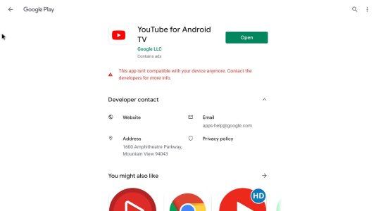

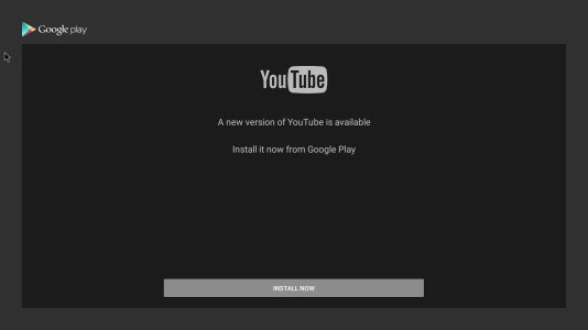

I have H96 max+ 2018 4G x 64G running Android 8.1 purchased in Oct 2018 (non clock version) recently Utube app stopped working asked to be upgraded. Google play said the upgrade is not compatible with my version Android.....c ur friendly supplier for a solution. Went H96 web site and downloaded H96 Android 9. Hooray Utube works using LAN internet connection; but WiFi no longer works. The box sees both 2.4g & 5g signal however putting in the pswd the connect request times out. Conclusion is the transmit side of the WiFi is not working. The difference between my and the current model is there is a clock screen fitted. So definitely there is a hardware difference. The reason why Utube couldn't be upgraded is that app is part Android OS. There are 2 approaches either modify Android 8.1 or Android 9
1 transfer Utube app from Android 9 to Android 8.1
2 transfer WiFi driver from Android 8.1 to Android 9
The problem with the app is not with just Utube Netflix & Google play potentially have the same issue!
has anyone a solution

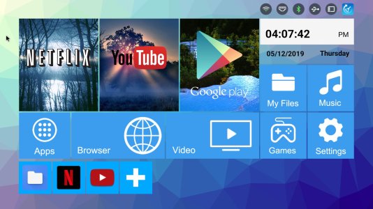

WiFi issue has been resolved. It appears there are 2 versions of the H96 max+. My assumption the difference is WiFi chip used in the current H96 max+ The 1st pie OS is a non "C" version. It too suffers from same problem cannot be upgraded here are some screen shots20191205_160742466.jpeg20191205_160846600.jpeg20191205_160944281.jpeg
