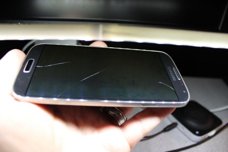

Here are 4 Samsung Galaxy S4s with the same exact issue and with the same exact crack.
The "crack" on all phones are starting right below the front facing camera.
Is this a coincident? I don't think so.
PLEASE POST IMAGES OF YOUR S4!!

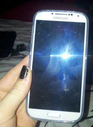

My S4 has very similiar problem. Went to answer a text and my phone screen was black except for the top 1 inch or so. There is a hairline crack across the AMOLED screen. My phone was in my front pocket and in a case at the time. I have no idea what caused the crack, seems it just happened on its own.
It's going to cost me $200 to have mine fixed.

Red hairline crack !
Same thing happened to mine. I haven't dropped it at all. It's in protected case and had screen film on it . can't upload picture to show
This exact thing happened to me. my s4 was only 10 days old and I woke up during the night to answer a text message, when my phone was just black and not letting me see anything, although the little notification light was flashing, taunting me and letting me know that I had messages I couldn't respond to. Initially I thought it was a software/hardware error, but after closer inspection I found some small little cracks under the glass that can only be seen when the phone is tilted a certain way. I had to think back if I had dropped it or knocked it but couldn't think of a specific time when this happened. It has also been in a silicone case since I got it. Initially the cracks had been small at only one side of the screen, and now several days later after NO use, it is right across. Thankfully it is insured and will be getting a new one through insurance, but this shouldn't have happened in the first place.
ALSO! the phone still works although the screen is black. My alarm went off at 6am the next morning and I couldnt turn it off except to take the case off, take the back off, and take the battery out!! which is hard work when you're sleepy.
So bottom line.. if you have one of these phones... get it insured!!! And find a way of disabling your alarm by using the power key or something =P
