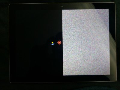

Hey all, just wondering if anyone else has come across this issue of half of the Pixel C screen going all pixelated/scrambled?
It's been doing this for a week now. I restart the device and it just boots with the screen like that. It's still touch sensitive (touching apps behind the scramble still launch them, I can still swipe from that side of the screen etc), but it's got that layer of pixelation on top of it.
I'll try factory resetting it and see what happens. If it doesn't fix it, might have to contact Google.
EDIT: Oh ok, seems like it's not an isolated issue: https://productforums.google.com/forum/#!topic/nexus/7BCFtjeGPdg
I'll factory reset and contact Google for a replacement.
Are you still on Marshmallow? Did you enable Multi-Window?
I was on Nougat preview and then it happened, so I rolled back to Marshmallow and it still occurred.
I didn't use multi window much at all when I was Nougat, don't really find it that useful.
I RMA'd the device and have gotten a new one from Google. No issues with this one now. Hopefully it stays this way.
EDIT: Actually, this new one I received has much improved wifi than my previous one. In a certain spot in my house, the previous tab would get <0.05 mbit/s but this new tablet gets over 6mbit/s which is pretty good.
After replacing my Pixel C 4 times now (RMA, same issue) I finally ran out of my warranty time. All four had the same issue (split screen). This time I removed the LCD from the chassis, I found that the LCD embedded ribbon (meaning the glued ribbon on the rear of the LCD screen was partially torn/ripped. I believe this happens due to an engineering mistake. You see the embedded ribbon make a sharp 180 degree turn in a tight radius and spreads along the edge of the screen, distributing the image to the LCD. This tight radius turn of a very fragile ribbon makes it susceptible to being under pressure (wanting to return to its manufactured nature) this when the inside of the tablet gets hot and when the user consistently pressing in that area (i.e. game playing, etc.) the ribbon starts to fail and then rip. This IS an engineering screw up and is consistent with this symptom everyone is experiencing.

Does anyone know if this problem cause by the cable can be fixed without requiring any replacement parts?
Sorry for the late response. In answer to your question, i would avoid the Pixel C all together. There are too many issues with this tablet one of which is poor engineering and it overheats easily. I have gone back to the Samsung Tab S4 10.1 display. the Samsung has not given me any issues whatsoever and I have been very pleased with its performance and reliability. It stands up to a lot of what I do, gaming, note taking, picture taking, picture editing, video editing. I think you'd be much more happier with a Samsung to tell you the truth. Good luck
