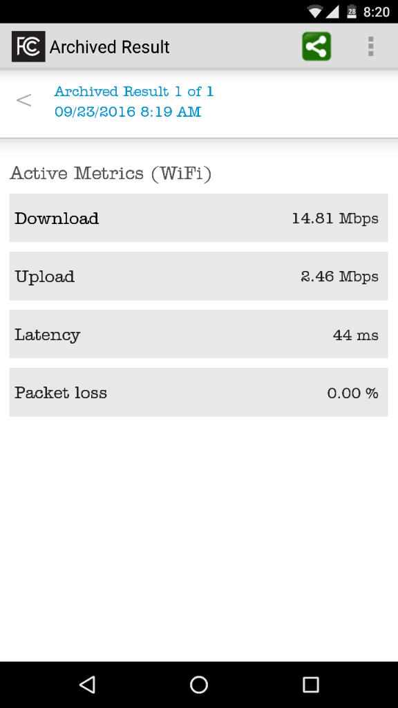

Have you tried using an app like FCC Speed Test https://forums.androidcentral.com/e...ps/details?id=com.samknows.fcc&token=6NHTnD8A (or any similar app) to measure your upload/download/latency speeds on both WiFi and cellular data?

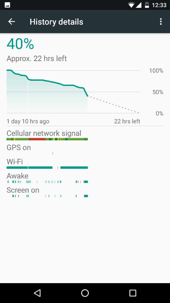

Have you looked at Settings -> Battery -> History details (touch the graph in the Battery screen to get to the History details screen) to look at your overall cellular signal?

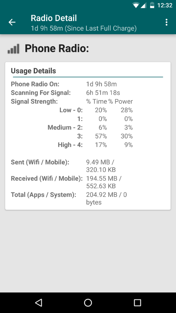

You could also use an app like GSam Battery Monitor Pro https://forums.androidcentral.com/e...etails?id=com.gsamlabs.bbm.pro&token=aIwDWcAj (there's also a free version) to see a better breakdown of cellular quality
For comparison purposes, since I'm also using Google Fi, here's a typical run of the FCC app for both WiFi

Of course your WiFi speeds will depend on what speeds you pay for from your provider (this happens to be on Cox; 2nd tier from bottom IIRC) and your cellular will depend on your signal at the time. YMMV.
