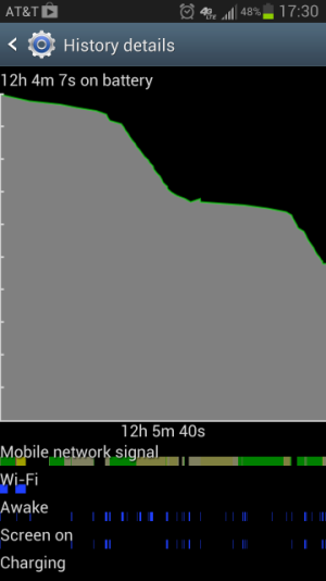

For work I drive around an urban city which causes me to switch through many cell tower areas, plenty of 4GLTE coverage. Some days the phone will be fine and others I'll experience the plummet issue. I'm hoping with an updated OS they may fix it, but this happened prior to me upgrading to 4.1.1 over Kies. Today it happened twice. Nice to know what the issue is but annoying that it's not being handled.

I'm in this boat as well. I cant turn off the just LTE, tried the safe mode and it had different options listed. I switched from the iPhone a last month and I LOVE it.....minus the horribly inaccurate GPS and this battery drain issue. I don't see them as wanting to fix this either. Just seems to be a "sorry, deal with it" kind of thing. the S3 is worlds better than the iPhone, but the battery drain on standby is quite an annoying thing. Last weekend the phone totally had no service and I thought it was because I was in a rural area but it was just error-ed out. It's substantially less buggy than the iPhones but I do wish we could get an update for this issue at least.
my issue is RANDOM. It is always when on standby. when I'm using it the battery barely drains. I'm wondering if I just leave the screen on forever if the battery will last longer. I have tried the "remove battery, leave out, charge fully and turn on" thing and it DOES work for a few days then back to massive drain again. I have been following this thread and trying things.

I don't see any indication of the plummet here...the signature being good battery life followed by a sudden and unexplained "plummet". You just seem to have bad battery life in general, based on the images attached. Your battery certainly could be defective, but it could also be your apps/usage.
