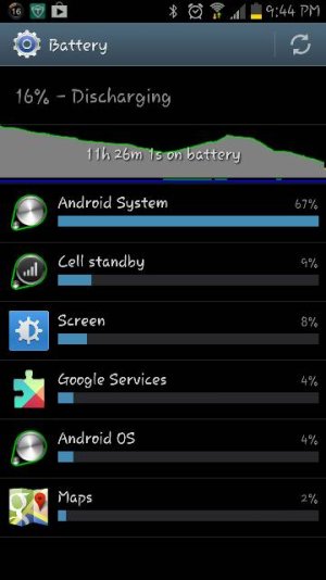

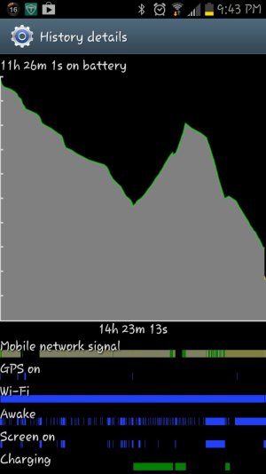

Forgot to include my screenshot from last nite...

Not saying you don't have the plummet but based on your screenshots I don't see the typical behavior...I just see bad battery life. A "plummet" graph would have a period of relatively stable battery followed by a sudden and unexplained plummet.
If you don't see that, consider searching about the gsiff_daemon error and install something like GSAM Battery Monitor to closely track what's using your battery.
