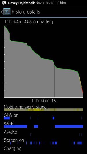

God help me :(

God help me :(
Haha join the club.
I wouldn't say your graph is conclusively the plummet...but definitely some hints there...only thing is there could be explanations. First drop in the beginning you had GPS on - maybe navigation with the screen off? I'm not sure what that straight down drop of like 8% is right at the end of the GPS time. The rest seems fairly normal until that last hour or so, which sure looks like a plummet even though there's a good amount of screen on time there as well...
I think I fell asleep early around 34%, then woke up and actually watched the battery drop to 6% out of nowhere!
