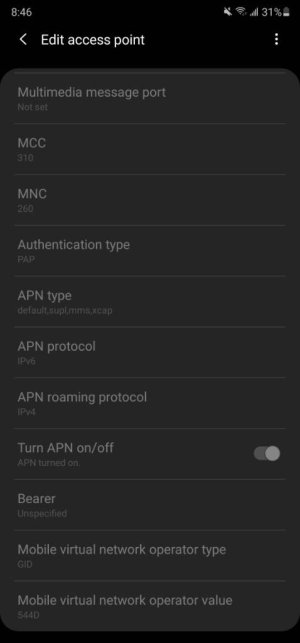

Strange , this will require a person physically look at it , might want take to Samsung experience store to run diagnostic or phone repair center
