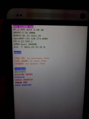

Have u seen ik stock everything. Cus i was waiting sense 6 ota update. But never came. And since does not use tap2wake. I decided to be a badboy and go for behind.
So i need help. I think this is the order first unblock bootloader, this seem easy. Then i have root to be able to s-off. But how my hboot now is 1. 56 since i kk4.4.2 sense 5.5 ota update.
So help. I catch up fast
Your steps should be unlock the bootloader, flash custom recovery, flash superuser .zip, then get S-Off.
Where did you get your instructions?
thanks dude! yes its what i ment =) just in less words. i unlock boot(adb... bin code htcdev giveme), then the recovery(adb twerp.....) then root(adb su......). everything ok . but when i try to s-off its the part where im confuse. since cant use revone or rumruner. but i still dont know if i try firewater. every tutorial is with hboot 1.54 or 1.55 not with 1.56. so im afraid to do it.

Use firewater if it doesnt work then nothing loss it wont mess anything up.
