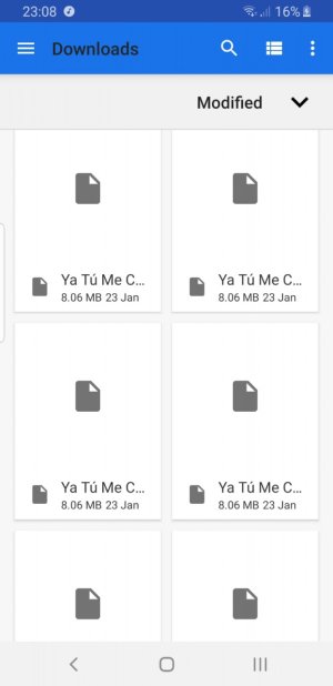

i can't rename them or do anything, i can only see them in this "file explorer" android opens when you have to select a file, for example on whatsapp and on that password management app i have, let me try to put a screenshot
here, this is the only way i can see the files, many apps use the same "file explorer"but its just to open a file, not to rename it or delete it etc

Did you also try a different file manager app as I previously suggested (like Files by Google, or Total Commander)?
yes, all of them, they only show in that android explorer when you have to select a file, on for example whatsapp, outlook, google drive, etc... i think ill have to live with it or do a factory reset but not worth it.
Ok, try this -- go to Settings>Apps, tap Menu, then Reset All App Preferences. Now, when you're in one of those apps and you want to select a file, does it give a choice for the file explorer to use?
no, it doesnt give me a choice, it just opens that file explorer from the screenshots, thanks for trying to help me man

It does appear, as B. Diddy said, that the phone is lumping in all files in a directory named /downloads/ as being in the system's Downloads folder - which is.just.plain.wrong.
Yeah, I recall Samsung's stock file manager being the main culprit that does this, but there are probably others that do it as well. They try to dumb things down for the user, but that causes more confusion in some ways.
