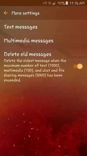

I checked my GS6E and couldn't replicate your issue.
Unless you exceed the numbers on the screenshot, I'm not sure what the problem is.

First check your settings. There's an option to automatically delete messages after a certain amount. Also make sure the stock messenger is set as default. Hope this helps ☺
Update: Settings we're triple checked and all is set appropriately. It also happens when not connected to wifi. I have att. Should I try calling them?
