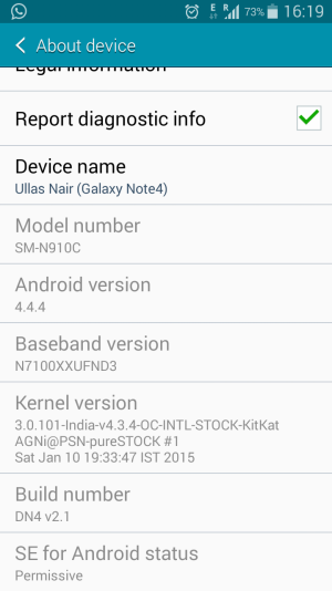

Hi GSDer,
My Phone SPECs
Make - Samsung Galaxy Note 2
Model - GT-N7100
recently my tech savvy freind upgraded my phone software to android version 4.4.4(kitkat)
since then i am facing this peuliar problem.... when my phone is kept on idle mode, and i try to get the display on by pressing the power button, the same dosen't turns up..... there is no timimg pattern for this phenomenon... anytime,...anywhere this happens... sometimes after call, when i look at the phone the light does not comes.....
the only solution i have is to kill the session by pressing the power button for 10 seconds and restart the phone.
Is this the problem of the latest version of kitkat....?
Can it be resolved without moving back to older version.
Please help me out
