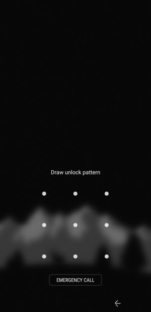

Note 9 recent tab and pattern unlock screen gives grey filter and dark spots
Hi im totaly new here. My galaxy note 9 recents tab and pattern unlock screen gives grey filter and dark spots on it. Previously i was using Note 8 and didnt have this issue.
It only happens if i keep a dark wallpaper and put screen brightness to about 50 percent or higher
I have uploaded a picture of what im trying to tell.
Plz help

Re: Note 9 recent tab and pattern unlock screen gives grey filter and dark spots
P.S : U will have to put ur screen brightness to maximum to see in the picture what im trying to explain
