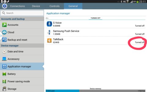

It's not an app you can Turn Off via the Application Manager... see the screenshots below... Don't know what else it could be :(

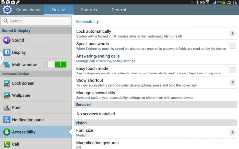

Thanks for your input... if you take a look at the screenshots you can see that I did turn it off (I believe that's what you meant by Freeze?) or are you referring to freezing with Titanium backup after rooting (really want to avoid doing that for now)

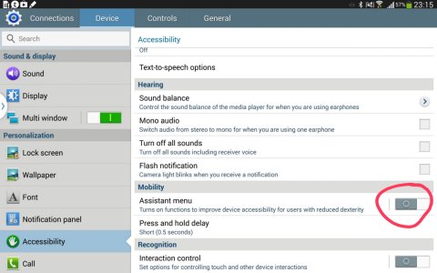

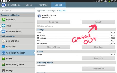

Hi Diane, I don't see an app called Handy Keys ? What I was referring to in my original post can be found on the Accessibility page, under the Mobility Menu... There is something called Assistant Menu which when toggled on, puts a small quick function white square icon that you can move around your screen. That I had toggled off, but was unable to Turn it off via the Application Manager.

Hi SpookDroid, for #1, I have been using Nova Launcher since Day 1 and for #2, if you see my first screenshot, you can see Talkback is already in the Turned Off column of the Application Manager.

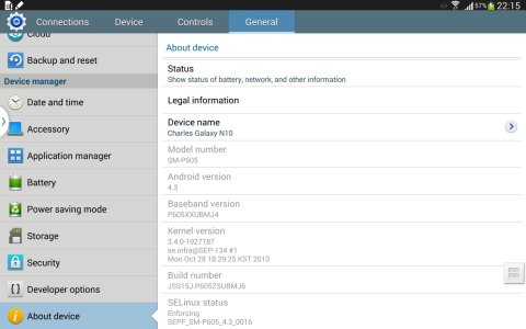

That's strange :eek: If you take a look at Post #5 on this page... the first screenshot, you can see the Turned Off column header. My baseband version is MJ4 and my build number is MJ6. I am sure that I must be missing an update as well... I don't have the User tab to add multiple user accounts... do you ? I never tried hooking up my tablet to Kies to see if there are any updates available that way...

Super weird...mine doesn't even have "baseband version" listed! I mean that category isn't present under About device. My build # is MJ4... don't think I got ANY update.
