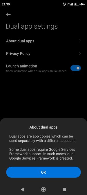

Can you post screenshots of what you can and cannot access, or what app icons don't respond - if that's the case.
Welcome to Android Central forums. I agree with B. Diddy, it sounds like you are not out of dual apps, or are somehow logged into a non-admin account, because what you are describing sounds just like what one would expect if they had no privileges. Limited access to apps, limited access to settings, limited access when connected via USB...
