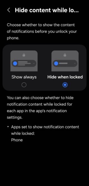

It sounds like from your post that you've already looked at the "Hide content while locked" options, and you're still getting too much detail? Would you show us a screenshot of the notifications after setting this to "Hide when locked"? Or show us a comparison of the two, On and Off.

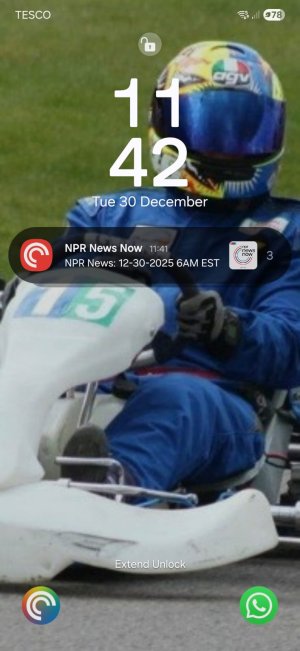

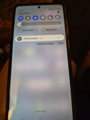

Thanks for your reply. It takes some time to test each change as I need to wait for a new episode to drop to see the effect of each change. I have subscribed to an hourly news feed podcast to help speed this up but working today and tomorrow so will have another dedicated looked at this on New Years Day when I will wake up my old phone so I can do a side by side comparison.
New phone is a Samsung S25FE running Android 16 compared to my old Samsung S20FE running Android 13.
So it displays the detail of the first new podcast episode just added.

Stripping this back to basics all I want is to see that there are new podcasts by just looking at my lock screen but I do not want to see the details of what those new podcasts might be.
Is this such an unusual use case? Should it be so hard to achieve?
I didn't have time to read through all your responses but in settings >notifications
You have brief on ?
Also you have hide lock screen content in the same menu under notifications?Screenshot_20260101_122414_Settings.jpgScreenshot_20260101_122405_Settings.jpg
Hmm
Strange mine doesn't behave like that with those toggles on I would have to unlock with my biometric to see the notification.
