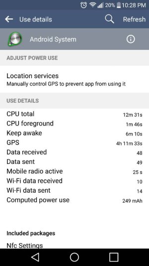

I've had this problem come and go (even before updating to marshmallow) and I cannot figure it out. It seems that my phone is using GPS a lot. Even if I have location services disabled. Some days it uses most of my battery. Even above screen. Anyone have ideas? I'm not using any smart lock features.

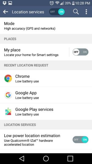

I'm having a similar issue. It's been going on since the T-Mobile update. I swear I put locations to the low battery setting but a couple times it seems to switch to the top one. Maps also keeps running while the phone is idle and eating battery as well. It says maps kept my phone awake for over 50 minutes over night. Anyway sorry to thread jack but the issues seem similar and wasn't sure it needed a separate thread.

For whatever reason, every time location is toggled off and then back on, it goes to the high accuracy setting by default.
My personal experience with location services is that GPS only is the best setting. Battery saver or low power cause more trouble than they are worth in my experience.
I use Access Lock to remove location permission (along with keep awake) from just about every app that I can (it's limited to downloaded apps).
My theory, whether it's accurate or not I'm not sure, is that with location turned off, something is trying to access location but it can't. And for whatever reason, it keeps trying over and over again which is why GPS use can be high even with location off.
I've used this setup (access lock with location permission revoked plus GPS only) for my last 3 phones (G3, G4, V10) and it's worked flawlessly.

I'll try setting it to GPS only first and see how it goes. I charged my phone before bed and unplugged it. It was at 100 percent and just sat idle for 7hrs. I look at my phone when I wake up and it dropped 10 percent in 7hrs. While sitting doing nothing. Checked Android system gps usage. Almost 2hrs of GPS usage. WTF? It was sitting untouched! I know this isn't a marshmallow issue as I encountered this before the update. Figured a reset would solve it. It did, but the problem seems to be coming back.
EDIT: Well, I've been using my phone for about 30mins at lunch and the GPS usage under Android system has climbed about 30 more minutes. So something has been pinging location this entire time. What I don't understand is I have not see the location/GPS icon on my notification bar at all. Not even once. Does this mean anything? I'm so glad google lumped so many things under Android system. Makes it easy to troubleshoot *end sarcasm*. Seriously, why isn't it just set to show what app requests GPS versus everything lumped into system?

I'm on 6.0. I manually removed location permissions for the google app. That app and play services are always listed under recent location requests. Never any other apps. So far, GPS usage has not started up again. Though I'm sure I've lost some functionality with google services by doing this.
