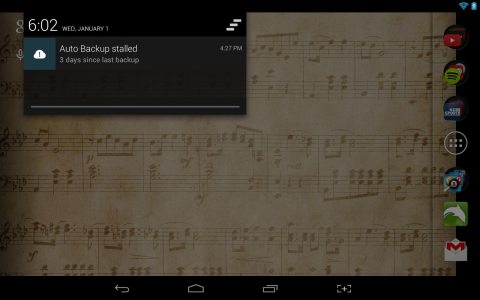

Hey fellow Sero 7 owners and Happy New Year! Glad to see this tablet has a following! Have to say it is an awesome device. Had mine since August with no problems. Did run into an annoying little issue though. For the past few weeks I have been getting an "auto backup stalled" notification. Is very irritating. When I click on it, it just goes away. Any idea what is causing this and how to get rid of it? I attached a screenshot. Thanks for your feedback and assistance!

I can't tell you what it is, but my wife has been getting the same notification on her phone. It has me stumped!

You have Google + setup to automatically backup your photos. I use that feature of Google + as a way of managing photos I take with my phone camera.
If you don't like it, go into Google + settings and disable.
