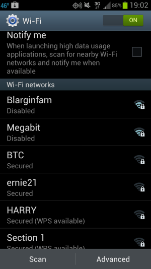

I have an issue where my home WiFi networks show "Disabled" and won't automatically connect when I come in range. Long pressing the network and selecting "Connect" connects immediately. "Keep WiFi on during sleep" setting is set to "Always" and "WiFi Power Save Mode" from the "Service Mode" menu is turned "Off".
Public Wifi networks such as McDonald's Wayport or Optimum Hotspot do not have this problem. Whenever I come in range of one of them, the phone connects automatically without any manual intervention.
What does "Disabled" mean in terms of a WiFi access points?
Has anyone had a similar problem?
What else can I check to see what is causing this?

"Disabled" status on a network connection/profile typically means something is blocking (for lack of a better word) the connection. Parts of the connection info being passed are okay, but not all.
I've often seen that simply changing the encryption method for your network via the router's admin panel (from AES to TPIK or vice versa, or setting to "auto") will address issues. If your router is set to filter on MAC addresses, make sure your phone's address is in the list.;)
Often people will swear up, down and sideways, 'til they are blue in the face, that they typed their wi-fi network's password correctly when setting up the network on their phone, but when they use the "show password" option they will see a character or two typed wrong. :-[

I have exactly the same problem with my Zopo ZP980
My home wifi gets recognized but always shows as "disabled".
When I select it and choose "connect" it connects without problems.
Thus it cannot be the router nor the password as the router doesn't know if I did a manual connection or if the phone did it automatically.
