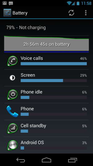

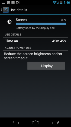

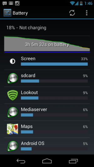

Since updating to 4.2 on Sunday, I've been having pretty horrible battery life.. I've attached a few of the battery monitor screens from today. Anyone else seeing significantly reduced battery life? My phone has been pretty hot all the time, even when not in use over the past few days.

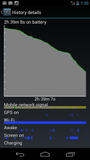

I wouldn't say mine is horrible, but it's been... inconsistent at best. Last Saturday, I got 2h on screen time with LTE turned on, but connected to Wifi all day. I turned 4G off to see if I could get even more battery, but then it tanked. I've been getting about 1-1.5 hrs on screen time connected to Wifi all day, this week so far. Not sure what the difference is. Could it be an app? I'm not seeing anything unusual in my battery settings, screen using up the biggest percent. What do you guys think?
Try 2x battery.This may not be the best fix but it is a great app. It really only does one thing, which it turning off mobile data when screen is off but it does it well. Back on 4.1 the best set up I had got was 4hrs and 2 mins of on-screen time and 13h 27m 34s on battery.

http://i50.tinypic.com/35iuplh.png http://i50.tinypic.com/2jc7gq8.png
I would use juice defender before 2x battery I've used both and by far JD works the best not to mention 2x battery was using to much ram and was stopping some of my phone calls.
