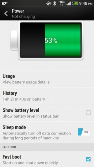

I'm at 60% after 13 hrs
Sent from my HTC6500LVW using Tapatalk 4
