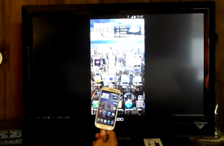

This is what happens:

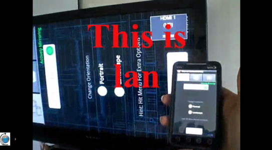

This is what I'm after:

Sorry for the VERY late response, but the first one is what you get. You'd need an external converter to get the second one. It's not a setting, it's the way Android is written. (We also used to have USB Storage mode and a few other things. Sometimes, one man's progress is another man's regress.)
