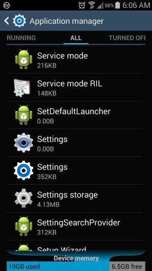

Re: Overrode long press for multiwindow, trying to get it back
Settings, Device, Application Manager, slide over to All, then the ones that show Settings and Settings Storage, click them and clear data/cache.
Thank you, I tried both with no luck. Wiping the Setting Storage actually killed my lock screen, notifications, and I couldn't even open settings afterwards. Luckily I backed up in TB before wiping, after restoring everything is back to normal but still no MW tray
