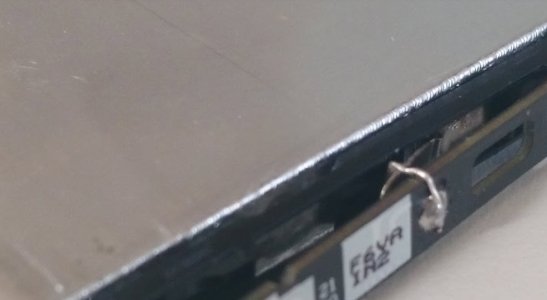

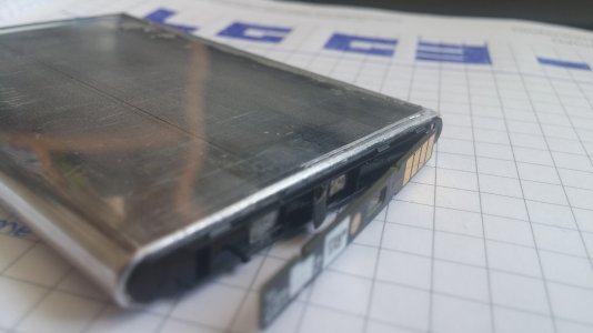

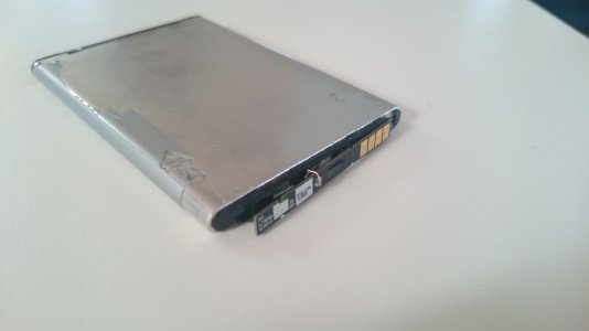

Here are some pics how I fixed the battery issue.
The plus terminal connection is bad so I just soldered a jumper across. Check my earlier post for details.
You need to peel off the plastic tape and flip off the cover on top.
Its fairly easy to remove. After removal the to cover, you'll see the tiny control boars as in pictures. If you lift it slightly, you'll see on middle section how the plus terminal is glued on control board. If you pull if more, the terminal will peel off from control board. And here is where I soldered the piece of wire. You ll see the wire on pictures.
Note..if you have tools and skills to do this..be aware that the terminal is plus..if the wire touched the metal body, it will cause a short.

I did this on two LG G3s. No restarts ever since.
Thanks for the explanation Marko Peltonen. I've bought a second battery but it only worked for 3 days.
Right now I've got an opened battery. Next: someone near with soldering tools.

I could not find anyone with a soldering tool, but I found a solution and a different explanation for why your soldered wire worked.
The solution is not the tiny wire you soldered, but just the tin you use to fixate it. It doesn't even need to be tin. A piece of plastic will do too. Please check my post in this other topic and draw your own conclusion. I'd love to hear what you think.

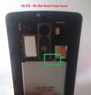

Did you try a piece (or multiple) that's thick enough? It should press the (negative) contact against the battery.

That depends, Vahooli. Of course, the capacity will lower over the years, but that should never cause a bootloop. The bootloop can be caused by a too low voltage, which should be prevented by the controller board in/on the battery. I was able to solve this, but it doesn't fix the lowered capacity.

Tip of the hat to @The_Core.
I was convinced that my G3 was rebooting due to thermal intolerance. Then, all of the threads said replace your battery, so I placed an order for some freshies.
However, just for giggles, I tried his suggestion of a small rotational spacer, which I made from a 2mm x 4mm block of thin cardboard stock. It's been doing the trick for more than 24 hours, now!
Thanks, The_Core! Your suggestion was the perfect solution to my issue. :cool:
