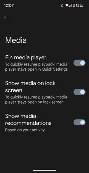

Turn the toggle off for media on lock screen this is under. Media when you go settings and type in search bar media, then when you need to get to that podcast just pull your notifications panel down 491788179.jpg

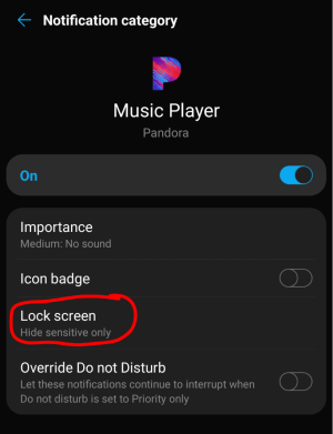

Does your phone have this option in the notification settings of the app? It gives me the option to hide notifications if I want, as Pandora uses notifications to display track and control info.

Turn the toggle off for media on lock screen this is under. Media when you go settings and type in search bar media, then when you need to get to that podcast just pull your notifications panel down View attachment 356246
I recently upgraded to a new Pixel 7a. It has the exact screen shown above. By disabling "Show media on lock screen" - there is only a 'partial' effect. It does hide the 'larger' media controls on the lock screen including the graphic icon of the media etc. etc.
But it still continues to display the title of the podcast or artist/song in a line of text immediately below the clock and date on the lock screen. This is more 'discrete'. But it is not a complete hiding of media being played. It also disappears when you hit pause on your ear buds or whatever.
It appears the only way to truly turn off media being displayed when playing is Settings > Display > Lock screen > "Always show time and info" to *OFF*
It must be the "...and info" part of this toggle option that allows media to continue to be displayed.
Turning it off turns the screen completely black. Increases battery life. But no time/date at a glance. And kinda sorta have to hunt for the fingerprint unlock.
At this point I'm concluding there is no way to turn off media display on a locked or screen blanked screen without turning off everything (clock/date/fingerprint target).
IMHO this is probably a feature oversight in Android - to have a setting to not display media that truly does not display media (rather than merely reducing it to a smaller line of text). Further that the setting work independently of completely turning off the clock/date etc. No biggee - would be nice.
Thanks for the feedback - it was constructive and I learned something.
Thanks for your feedback on this as well
