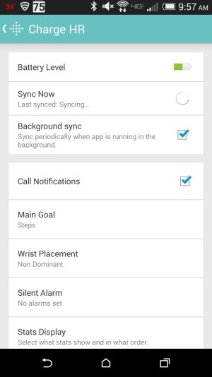

Hi, the settings are on the the phone app itself. Go to devices, Charge HR and make sure call notifications are checked. There are some other cool settings there too.2015-02-27 14.57.42.jpg
Hope this helps
