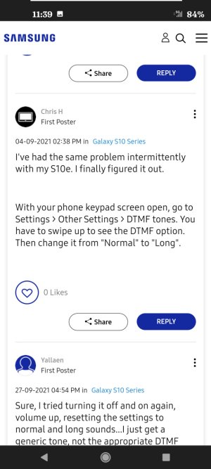

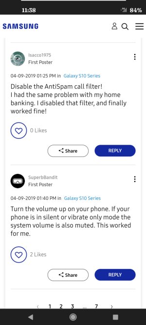

Here are a few things to try. It's for the s10 but might be same on your phone.
