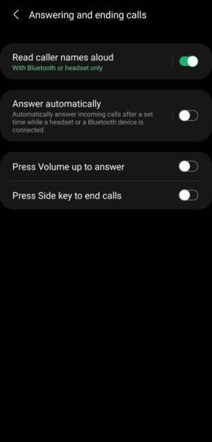

Which phone ? On my Samsung in the phone app settings you have option to keep the call screen in full screen so it doesn't shrink or end calls and answer with volume or side key Screenshot_20210925-231636_Call%20settings.jpgScreenshot_20210925-231612_Call%20settings.jpg
Yes i have these settings like this..but my issue is during the call i see only homescreen...and i can see call is on the notification bar in green color..my phone is samsung M02s
